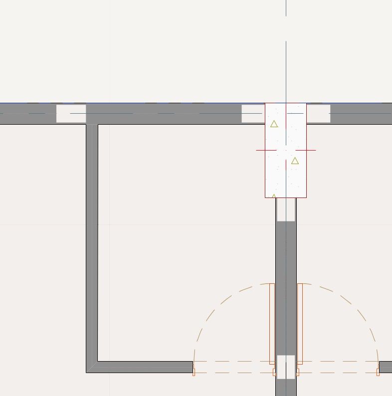

I have a problem with the representation of elements in archicad.
i am working on 2 different view maps
In the first one I don't want to see the secondary structure. In the second one I need to see them. but the problem that i got is, for the materials priority of the columns, when I hide the layer of the secondary structure it still make a hole in my walls. If I change the priority if the columns materials to be less important of the walls, I got the opposite problems, I mean the secondary structure won't be visible even if the layer is on because of the walls priority.
I don't know if there is a settings in archicad where you can configure that when a layer is hidden, the elements of this layer don't have any impact on the others elements.
I don't know if i explained well my problem and hope that someone can help me. I joined two screenshot of my two view maps.
Thanks in advance.
Alex

Bolabo wrote:In your Layer Combinations make the Intersection Priority number 0 for layers that are turned off, and they will not interact with layers that are turned on.

Thank you so much!
It was so easy but i didn't figure it out.
