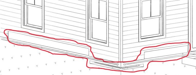

missing wall segments along the bottom of 1st story
Along the floor-line of interior and exterior walls, I'm getting missing segments.  They appear as cutouts in random places.  When I drag the walls away from the building, the cutouts disappear and the walls are solid bottom to top.  "Clear all connections" did nothing.  Thinking that I had hidden overlapping structure, I started deleting objects to try to determine the culprit (leaving only the exterior walls).  The cutouts remained.  I'm out of ideas.  Anyone have thoughts?

these are likely elements on hidden layers that are interacting with the walls on visible layers.
in your layer manager (com+L or document > layers), sort by layer visibility in the right column. Select all layers not visible, and set those layers to layer group 0. Group 0 does not interact with any other elements, even the same layer. It is a great strategy for isolating hidden layers and preventing them from cropping out your model like this!
make sure you update your layer combo so it's not using a random "Custom" layer combination.
additionally, if it helps, think of layer groups like a language barrier. Layer 0 can not communicate with anything. Layer 1 only communicates with layer 1. Layer 2 with layer 2.

DrCADD
Thank you, Parick!  Model restored! 🎉
Patrick M
make sure you update all relevant layer combos... you'll get a month down the road and need the elevations or sections too 😉
