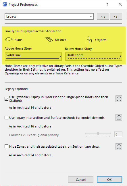

While preparing the floor plan of my foundations, Archicad displayed my mat foundation slab in dashed line although my storey settings and floor cut plane were set correctly and my slab should have a solid line contour. Even when I changed my hidden line line type to solid line, the line still was dashed. I managed to get the correct solid contour after changing the home storey of my slab from ground floor to foundations, which makes common sense in this case.

Your ground floor slab is above your foundation storey, so if you want to see it in the foundation plan, set it to show one storey down.
Check your Project Preferences to see what is set for the slab above home storey.
You will probably find the 'slab below home storey' is set to a dashed line (this is my preference).
That means the slab you are viewing above will be dashed.

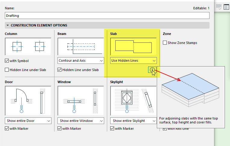

The 'hidden' line type is for when you have two slab butting up next to each other (at the same height).
There is an option in the Model View Options to show or hide the connecting (hidden) line.
