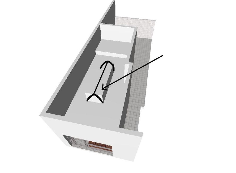

Im designing a shop.And I dont know how to make an arch on the ceiling(horizontal arch).I ve tried with the wall and tha slab tool and i cant find any options.Also with the roof tool the only optionis to make a Domme or barrel vaulted.PLEASE HELP ME!!I attouch the following sketch for better understanding...Excuse my English again!!

You will need to create the arc for one side only, thendial in your magic wand settings, and use the barrel vaulted geometry method of the roof tool and the magic wand to create one side, then mirror a copy it over.

Easier than dealing with the roof tool and making a barrel vault roof,
is to use TrussMaker. It makes a smoother looking surface with no joints.
It may be possible to make a barrel vault using a complex profile wall.
Peter Devlin

Better yet... If you use the beam tool it will automatically cut its own hole in the slab.

Can we agree that what you want to make is what is commonly known
as a barrel vault roof with 180° of included angle ?
If so, there are several ways to accomplish this.
I will only describe two ways hear because they are the easiest
to describe and the easiest to do.
One- use the "Shell 10" object in the Basic shapes folder in the
Archicad library.
Two- Use TrussMaker. Draw an 180° arc in a section/elevation window
Make the radius of this arc the radius of the under side of vault
plus one half the thickness of the vault shell. Select the arc,
go to design extras->TrussMaker, select the cross section shape
solid beam, enter the vertical dimension as the thickness of shell
make the width three or four meters, and hit OK.
In plan you will see the 2D symbol of the barrel vault with
center line lying along the section tool line. Stretch the
2D symbol to the length of the vault you want and check
in the 3D window and see if the vault is what you want.
Peter Devlin

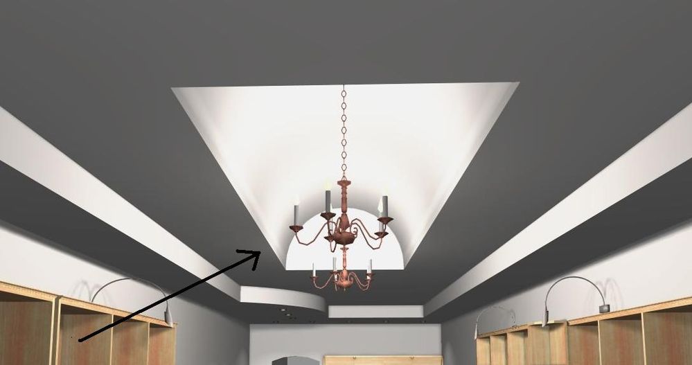

The result was really good and the way using the 'shell 10' object more than easy!I must be blind not to see it my self.Thanx a lot again Peter.Here is the result....

Using the profiled beam method, I just put this together in a few minutes. The beams are each half the vault so that they can miter properly at the groin.
