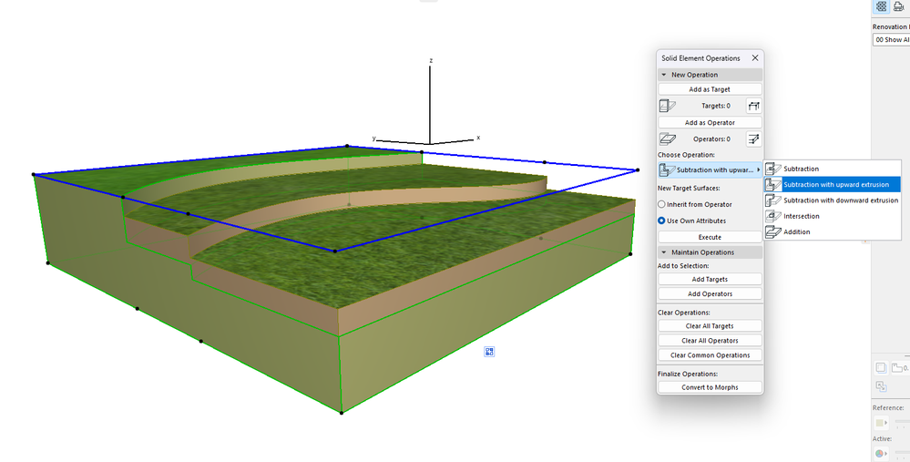

How do i turn stepped site into mesh site?
enea-x
1 REPLY 1
Hi @enea-xx,
I guess you need to learn how to use the mesh tool to create the whole mesh & some contours.
You can take a look at this free course provided by Graphisoft Learn Portal, that'll give you an introduction to mesh.
Kindly, take a look at this shot showing how to use SEO for creating a stepped site.
