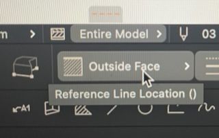

I assigned 'C' to another function therefore removing it from being the preset shortcut to change the reference line location when drawing walls etc.. the problem is now I'm not able to assign another key in place of 'C'.
Under 'Keyboard Shortcuts' in the 'Work Environment Settings' I have searched for 'Reference Line Location' to reassign a key but cant seem to find it.... any suggestions?

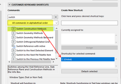

Make sure you are looking in 'All Commands in Alphabetical Order'.
Depending what version you are using you should also be able to 'search' by typing part of the command (of course you have to know what the command is called).

The command you want to add a new shortcut to is called "Switch Construction Method".

Thanks Barry, but still no luck with that one either. No such shortcut pops up when I search for it. Any other suggestions?

Ahhh yes got it!! I wasn't searching under 'All commands in alphabetical order'!
