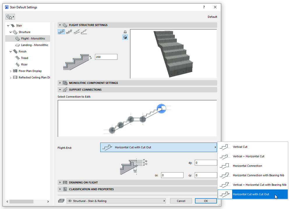

How should I connect the slab and stairs in 26?

1. How should I connect the slab and stairs in 26?
2. Where should I put the last of the stairs?
I'd like to know your thoughts.

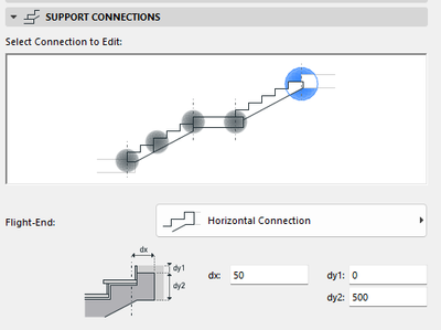

Choose the "Horizontal Cut with Cut Out" option, and set the parameters properly for correct connection.

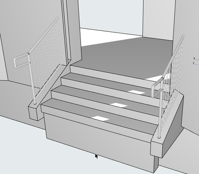

Could I see your floor plan if possible?
I think this is the best.
