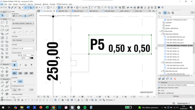

I would like to change the dimension units in AutoText labels from meters to centimeters. I already tried changing the project preferences dimension units to centimeters, but the AutoText label still shows the value in meters. How can I make AutoText display dimensions in centimeters?

It is calculation units that you want to change.
But this will affect all of your schedules as well if you use them.
