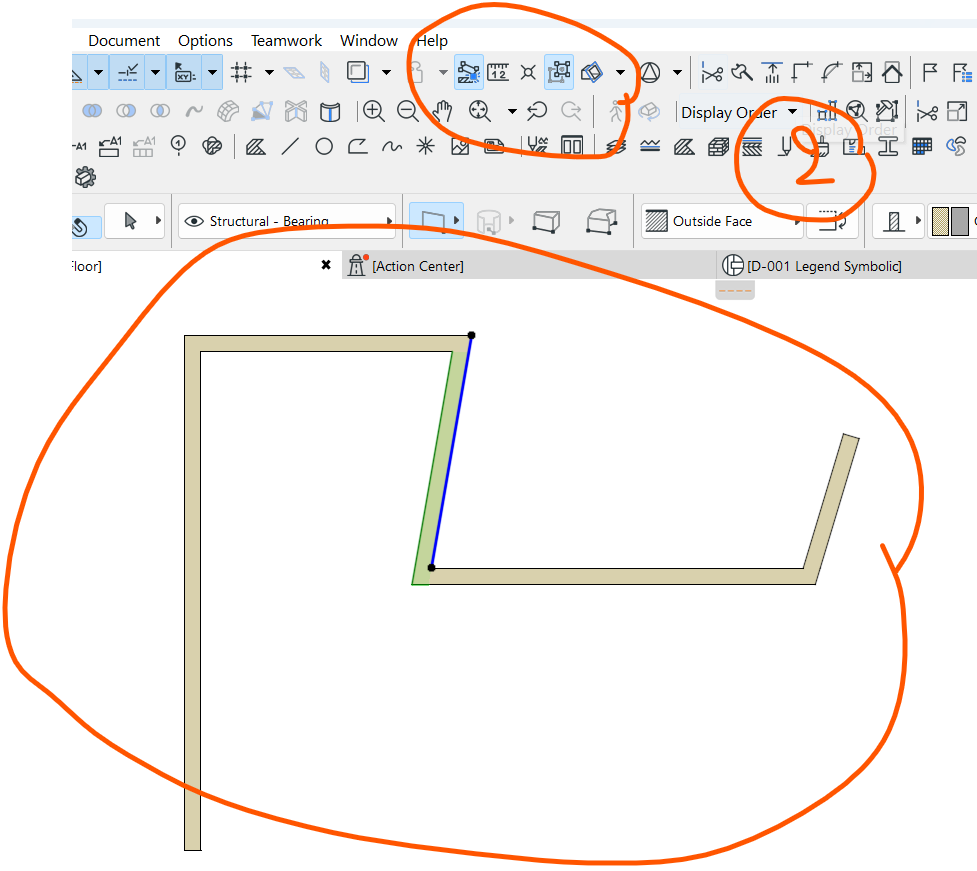

I'm having an issue with the "Suspend Group" command in my current project. When I try to select a wall that's part of a group, the program automatically selects the entire group in a "Suspend Group" mode. However, when I start a new project, the "Suspend Group" command works normally, and I can select individual elements within a group. I'm wondering if there's a way to fix this.

I am confused by the image you show.
Grouping is not suspended - the button will be highlighted when it is.
And the wall is not part of a group anyway - the nodes will be round coloured circles rather than black dots.
Can you show the same image but with the problem group?
Image 1 :suspend command is not select. when I select wall.  wall is separate and not connect.

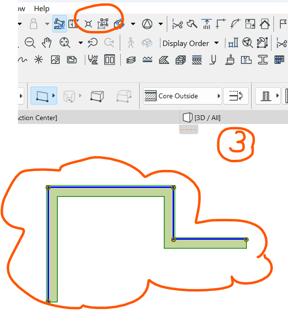

Image 2: Suspend command is turn on. Wall still not connect.

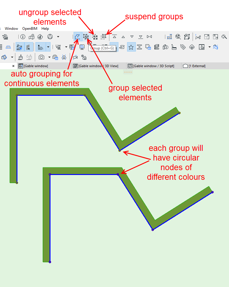

This wall create by new Project is look ordinary wall continued by chain (Image3) But if i use previous project wall still single not chain wall.
