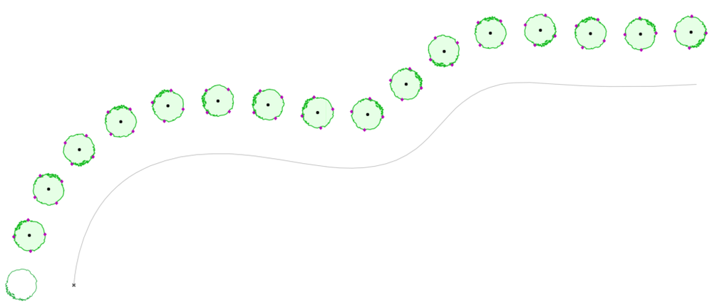

  1. Now that you have your path, place on instance of the element you would like to distribute on the beginning of that path.
  2. Select the element, and click on one of it's hotspots, to enter editing mode, and select Multiply from the Pet Palette.
  3. In the Multiply dialogue, you have the usual options for distributing elements. For this, we will need to drag our element, so under the drag option, select how you want to spread it (by length, distribute a certain number of elements, increment or increment and spread).
  4. After setting this up, make sure that in the lower part of the dialogue you have "Pick Path before Input" ticked.
  5. Select whether you want the copies to be rotated according to the direction of the path, randomly, or not at all, and then click OK.
  6. Now, you will need to click on the path you want to distribute the elements on (if you click on one of the object's hotspots, you will return to the traditional drag method, when you drag the copies along a straight path).
  7. Next, you have the possibility to offset the path. This is useful in case if you want to distribute trees along a road, which you already have modelled. Wherever you click down, that will be the start of your path.
  8. Now do the drag multiplication along the path, according to the selected method.
Note: If you pick a path outside the element, it will consider the beginning of the path as the center point for the element/rotation. This is particularly visible when you randomize the rotation.
