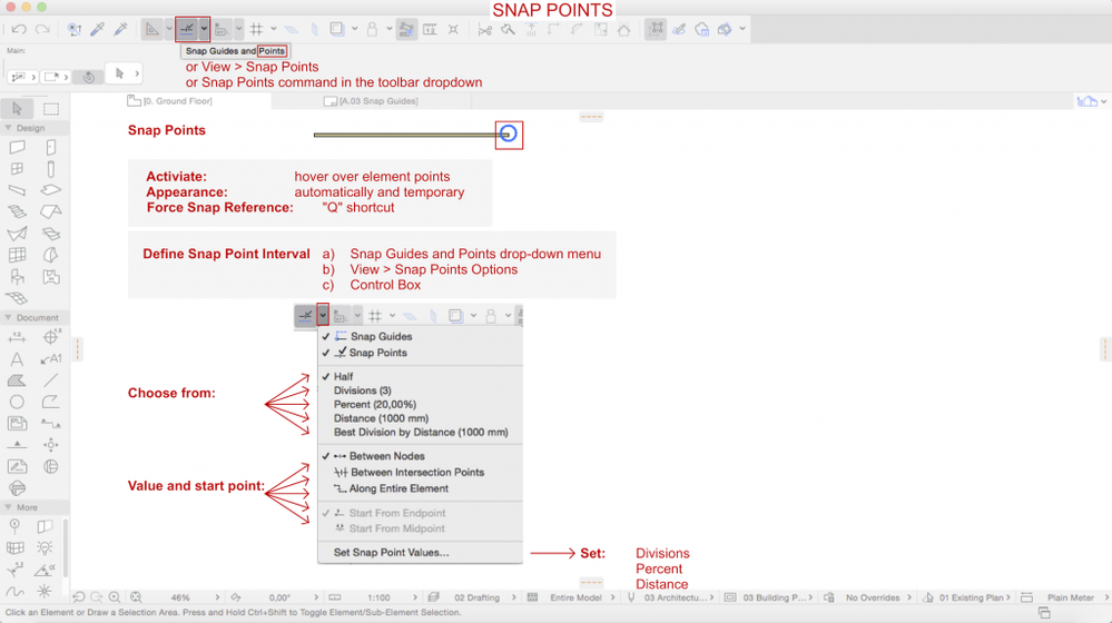

Snap References Snap References are temporary lines, arcs and points that appear along existing elements, to assist accurate element placement. There are two types of Snap References: To make them appear at multiple places that are relevant to your input, you can define any edges or points as Snap References. Activate a Snap Reference (a dynamically appearing blue highlight) by hovering the cursor over element edges or points. (You can deactivate them by hovering over the Snap Reference.) You can activate any number of Snap References simultaneously. Once you have defined Snap References, you will see Snap Guides and Points appear. They appear with a blue dashed lines and arcs/circles.
Snap Guides indicate the relation:
  • Tangent
  • Parallel
  • Perpendicular
  • Angle Bisector (if applicable)
  • The line connecting two circles’ centerpoints (if applicable)

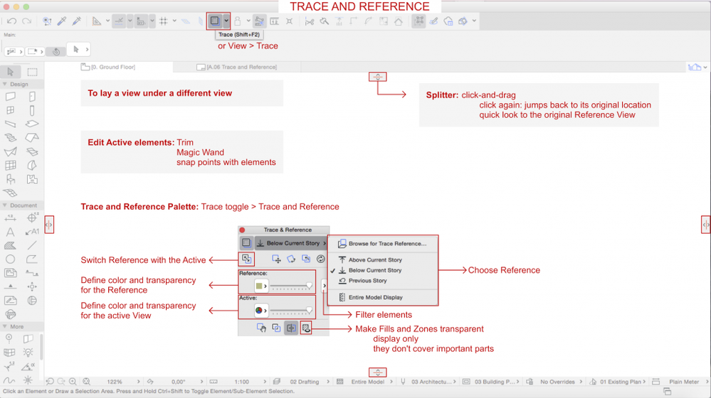

Trace and Reference In Archicad, you can lay a view under another view in any model or layout window. It makes it easy to compare model views/drawings on the same screen or you can use it as a temporary editing aid. For more information see

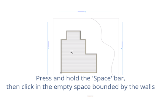

Magic Wand
The Magic Wand (shortcut: Spacebar) finds and traces a linear or polygonal shape from among existing elements, and then helps generate a new element based on the traced polygon. Magic Wand can be used in 2D and in 3D as well.
  • If you click on an edge or node, the Magic Wand traces the element and/or the element chain.
  • If you click in empty space, or on a surface, the Magic Wand traces the closed polygonal area formed by the nearest elements.
Activate a Design Tool (eg. Slab Tool) and hover your mouse over an edge or empty area of an existing element. Press the Spacebar, a preview will appear, then click to place the element. For more information see Magic Wand

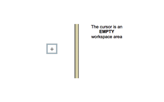

Intelligent Cursor In Archicad the cursor shape indicates the actual position of the cursor helping you to find edges, points or reference lines. For more informations see Intelligent Cursor
The cursor snaps to nodes and edges if it is within a certain distance from them. The shape of the cursor sends you the feedback that it has snapped to a node or an edge. The sensitivity of the cursor can be set in Options > Work Environment > Input Constraints and Guides > Cursor Snap Range (the range is given in pixels).

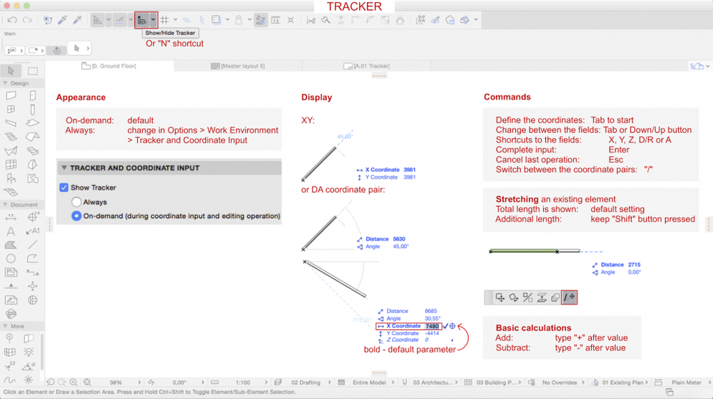

Tracker For entering distances in Archicad the Tracker is used. Entering distances works the same way in 2D and in 3D. The Tracker appears during element input and it follows your mouse movements, constantly providing feedback about the distance and angle or/and the XYZ coordinates calculated from the starting node. Use the dialog box at Options > Project Preferences > Working Units to define the units are displayed in the Tracker. For more information see How to enter distances in Archicad

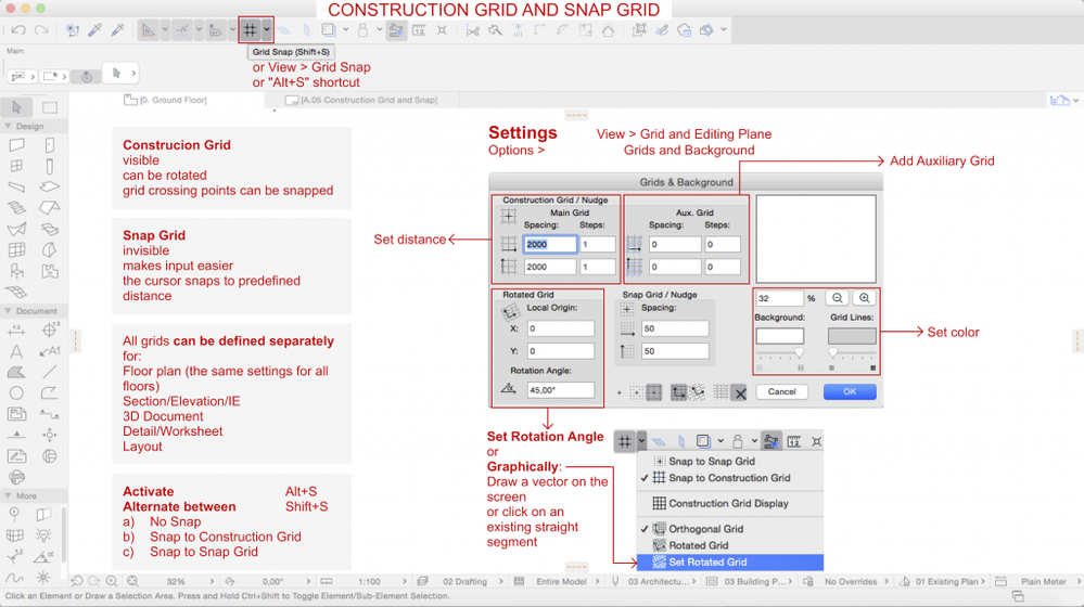

Construction Grid and Snap Grid Construction Grid and Snap Grid are provided to help you make drafting easier. The difference between them is, that the Snap Grid is an invisible grid that you can use optionally to make input easier, by having the cursor snap to a predefined distance. The Construction Grid is visible, it can be rotated and if the “Snap to Construction Grid” option is checked, the grid crossing points can be snapped to as well. Grids can be defined separately for the Floor Plan and any individual Section/Elevation/IE, 3D Document, Detail/Worksheet, or Layout window. (Note: in Floor Plan window, the same Grid settings will be used for all Stories.) For more information see
