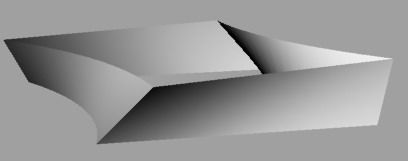

Hello,
I am trying to create a wall that is slanted in two different directions, see the picture, but I haven’t been able to figure out how to do. I have looked at the complex profiles tool, but I have only managed to create a wall that is slanted at the same direction in both ends, not in opposite directions.
Anyone who knows how to do?
Regards,
Katarina

Cannot think of a way to do this with walls of the top of my sleepy head.
But, you can create those shapes with GDL script ... or visually in ArchiForma (Cigraph plug-in). Just a Ruled surface (either GDL or ArchiForma) would do it...with the top and bottoms of your walls being the match lines unless the wall is to bulge too... then probably need a Coons. The result would be an object, not a wall.

I was wondering whether your "Skewer.gsm" object could be used
to twist another object with a simple rectangular cross section.
Otherwise, the only way I can think of, other than the GDL commands
you have mentioned, is to use the TUBE command with an incrementing
angle parameter in a multi-segment path to create the twist.
