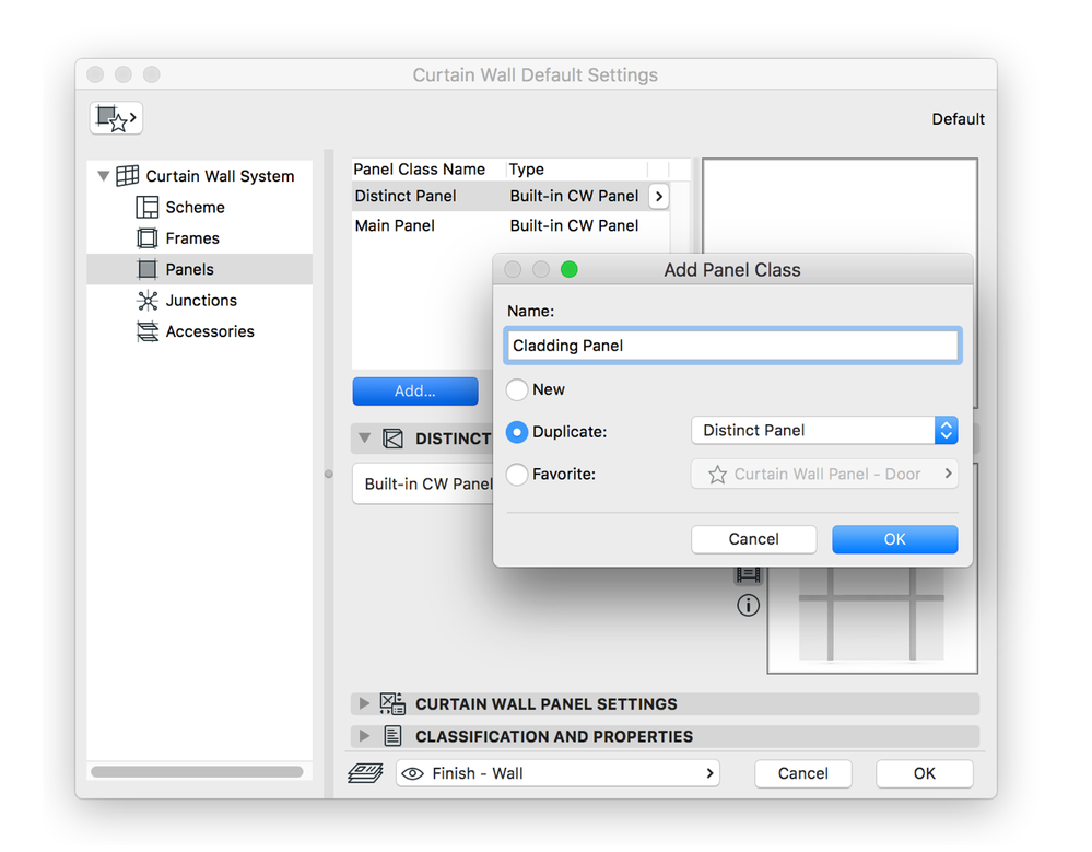

For that, open the Curtain Wall Default Settings dialog, go to Panels level on the Curtain Wall System and click Add to create a new Panel Class called: Cladding Panel. Press OK to leave the dialog.

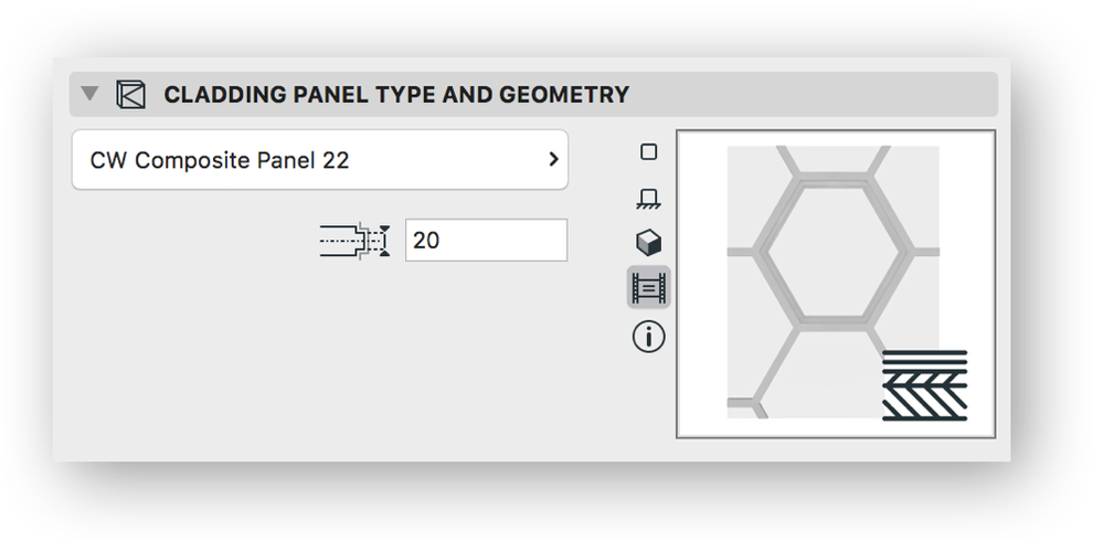

After creating the new Panel Class, go to Cladding Panel Type and Geometry to select the best Panel Type for that purpose. ARCHICAD 22 has some new GDL-Types available for Panels. One of them fits perfectly for the cladding purpose, it’s called CW Composite Panel 22.

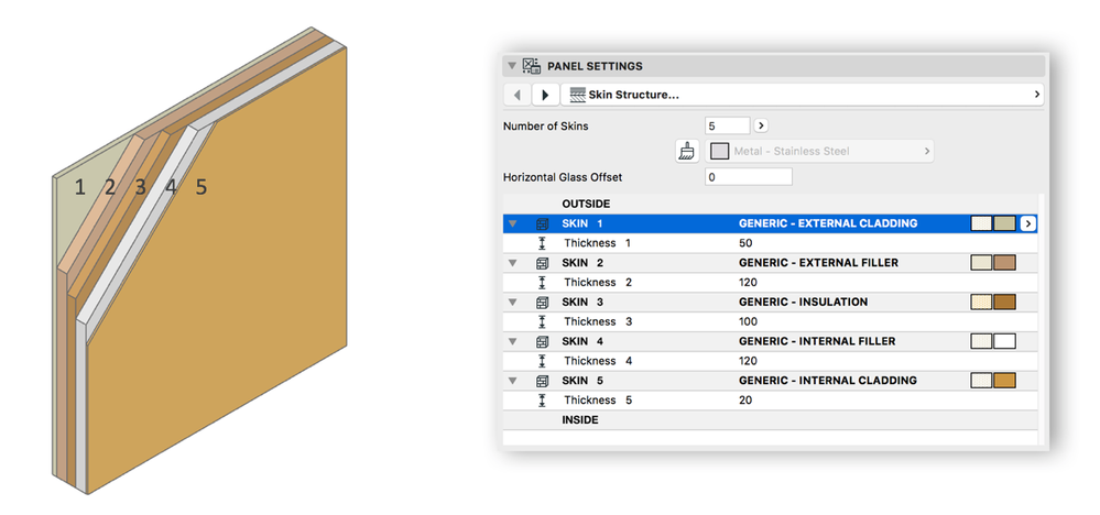

Select this option and start working on its Panel Settings. On the Skin Structure tab, you can edit the number of skins desired for the cladding composition you need to build up. Choose the Building Material and thickness for each skin, organized from the outer part to the inner part, from the top to the bottom list, respectively. Note that now Curtain Wall components are using Building Materials, so you can take advantage of the Building Material intelligence.
For the chosen Panel type, you can set various parameters available like is usual for GDL-type components. Note that you can override the Model View Options settings for its 2D and 3D Detail Levels, as applicable. See below the result for this Skin Structure composition applied to a Curtain Wall segment.

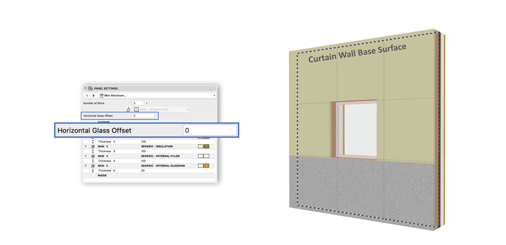

The Horizontal Glass Offset option will allow you to move the panel composite in relation to the Curtain Wall Base Surface position where a glass panel could be located.

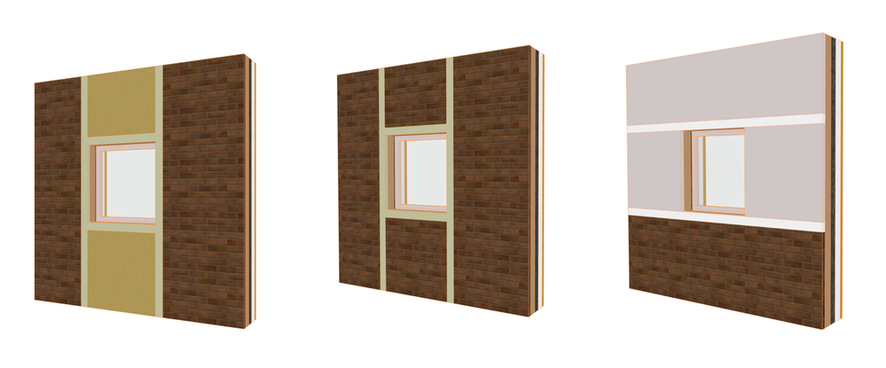

Using different composite variation for CW Composite Panel 22 you can create many special patterns for your façade design! Use your creativity and have fun!
