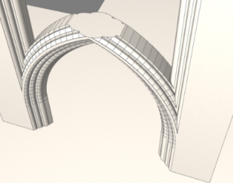

The Shell Tool that was introduced in Archicad 15 is a very versatile Tool. However, as its name implies, it is a Shell, it is a body of constant thickness generated onto a membrane.Archicad users may encounter situations where they need the Shell to be a solid body instead of an element of constant thickness. There is a trick you can use to achieve this. It involved using the Trim elements to Roof/Shell command. The following example describes how to do it. The vertical pieces in this scenario were modeled using complex Columns, we have no problem there creating solid bodies. However, the curved piece could only be modeled using the Shell Tool. The Shell is not solid. How can we make it solid? In order to achieve this, we use some creative thinking. We will model a Wall piece and will trim this Wall to the Shell.

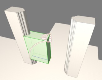

Step 1
Create a Wall large enough so that when trimmed by the Shell it will give us the geometry we want.

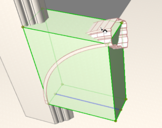

Step 5
Move your cursor so that it finds the inside of the Shell. The blue pre-selection highlight will give you feedback on which part of the Wall will be kept if you click the mouse. Alternately, you can hold down the CTRL (Windows) / CMD (Mac) key which will enter trim mode as shown by the Hatchet cursor shape in the following image. In that case you specify the part of the Wall to be removed. It is important to note that regardless of which method you use the pre-selection highlight will always show the part that will remain after the trim operation. In this image we can see the cursor is located on the outside part of the Wall (that part of the Wall that falls outside the Trimming Body of the Shell), the shape of the cursor is a Hatchet (so the outside portion will be removed, not kept) and the pre-selection highlight is on the inner portion of the Wall as that portion will be kept under these conditions.
