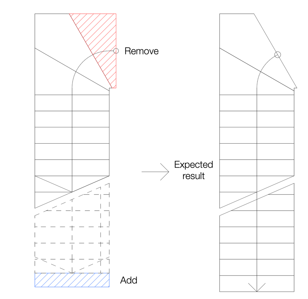

I am currently working on a personalised staircase and would appreciate some help, as I am struggling to achieve the design shown in the attached picture. I have created an illustration using Archicad to explain what I am aiming for.
Any assistance or insights would be greatly appreciated.

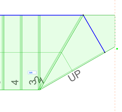

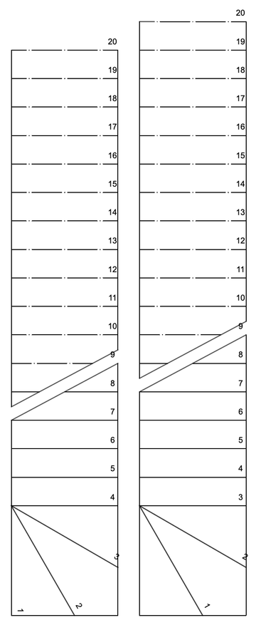

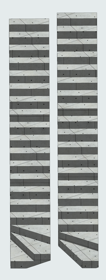

It is possible to start with a tread, this adds a step and shifts the numbering but the 2d representation is not as you want it...
There used to be a function to create a stair based on a fill but I cannot find it anymore: "Create Stair Using Selection"
