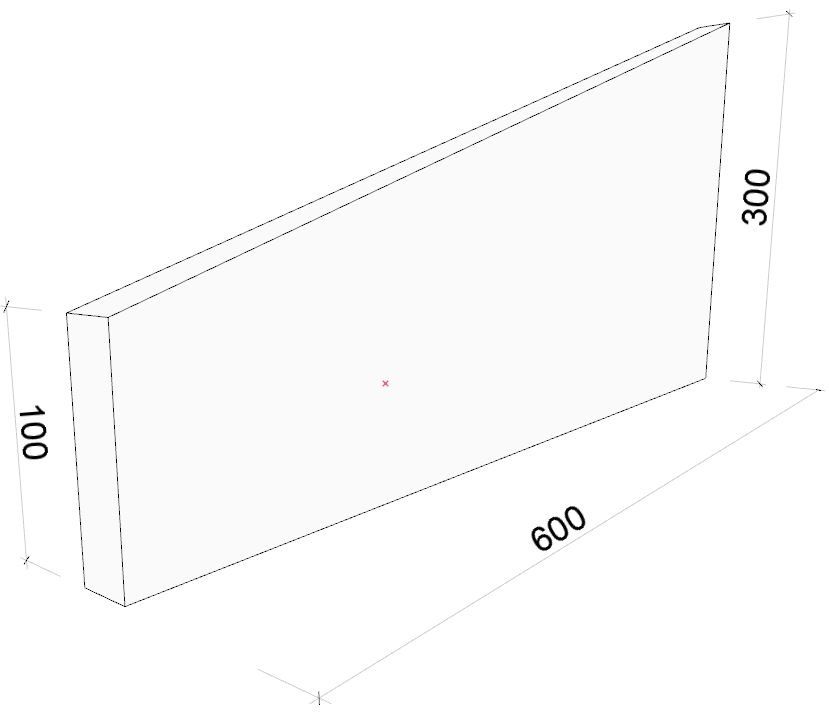

anyhow, please could anyone tell me of how to draw a wall wich say starts at 1m high and then gradually inclines to 3m over the distance of say 6m?
i basicly want a wall that starts lower and inclines, have tried to find a way but i have a deadline coming up and so running out of time to find out for myself!!

can you post some pic want you want...just sketch it with lines and i will help you.
the side wall of the building i have drawn and attached, is what i need to draw, it is higher at the front of the building and then lower to the rear.
thanks so much,
cheers Joe
here is the drawing again without the roof on 🙂
soemthing like this ????
yeah thats the thing i mean 🙂
