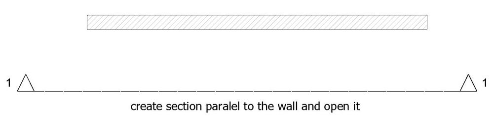

hi, newish user of archicad, use mainly autocad..
anyhow, please could anyone tell me of how to draw a wall wich say starts at 1m high and then gradually inclines to 3m over the distance of say 6m?
i basicly want a wall that starts lower and inclines, have tried to find a way but i have a deadline coming up and so running out of time to find out for myself!!

i will create you a little tutorial with complex profiles !
whait a few minutes

Sounds like you have used the Solid Element Operation to trim the wall, rather than the less used "Trim to roof" command. Trim to Roof is permanent. SEO adjusts as you move (or delete) the operator.
1 step
2 step
undefined
3 step
4 step
5 step
6 step
