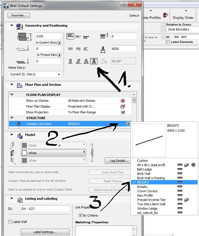

Now select WALL TOOL and folow numbers 1,2,3
You will have to select your profile...you allready named it before you exit lstep 8. My profile name is BRISATI...you must select yours

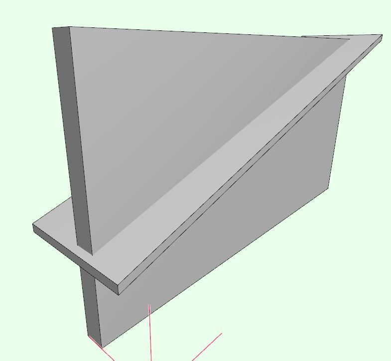

this is my 3d view. and i see that my profile is not positioned as it supose to be. SO i will move it around,,,rotate it on plan and finaly i will put it where it must be to cut wall

You can see my 3d win. I move my profile...change it size and place it in place. It will CUT my wall to my desire shape

you see in section too that i placed PROFILE in place and its ready to cut my wall
Use your section, plan, 3d window to move and place at right place profile

If you edit shape of your profile and wall will be cuted like that shape.
To edit your profile go to Complex profiles - Profile manager
REad about this...you will need it A LOT
It this case we use profile to cut wall...but you can use profiles to get different shapes and you can use them with WALL, Beam and culumn
I hope that you will be able to folow this steps and i hope that this helps you.
OFC this is stupid and archicad wall supose to be able to strech and edit just like archicad slab tool. This all is workaround
