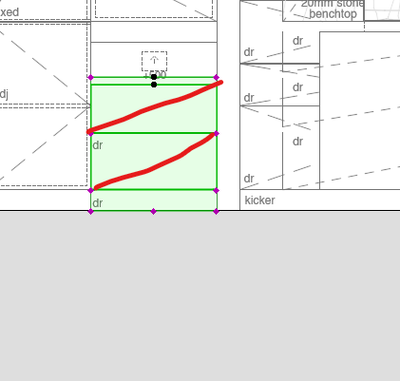

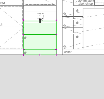

Hi there, I am using base cabinet blocks in elelevation. Please tell me how I would add a specific opening type for the drawer (i want the opening line to be a slash (image 2).
The green shows the base cabinet object I would like to put a slash through.
This is what I want it to look like:
Is there a way to make this happen within the object settings or can I somehow edit the object to make the opening lines look like this for drawers? Help/.

I use a seperate custom 2D object to do all of the opening lines and annotation...
Editting the object would be rather complicated as there are a few layers of macros that you would need to filter through.

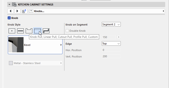

Another question - is there a way to add finger pull to these cabinets?
Have a look at all of the different knob options...
