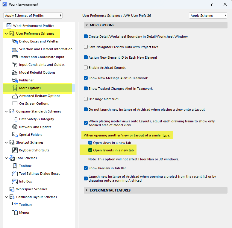

There is an option in the Work Environment that will force all new layout pages to open in separate tabs.

‎2024-02-27 04:45 PM
Thank you, Barry, this is what I was looking for!
