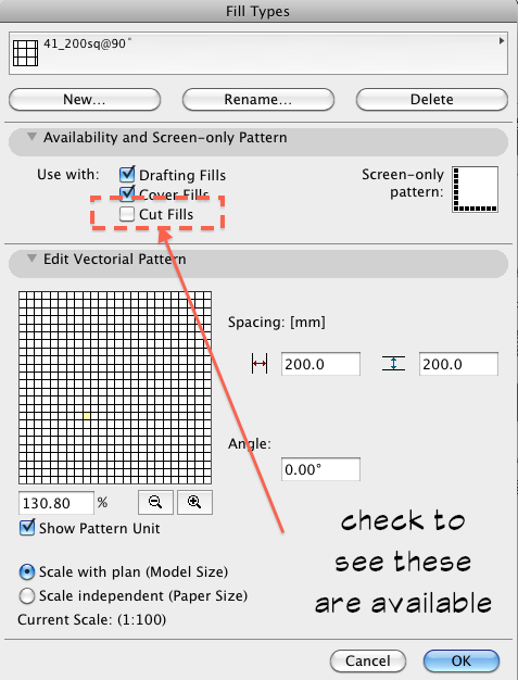

Rod Jurich
smartgurl911 wrote:
/..... no hatchings to choose from...
there are no hatching types, /.......
You may want to check your available cut fills.
Rod Jurich
AC4.55 - AC14 INT (4204) |  | OBJECTiVE |
that box is already checked. I unchecked it then re-checked it but still nothing.
