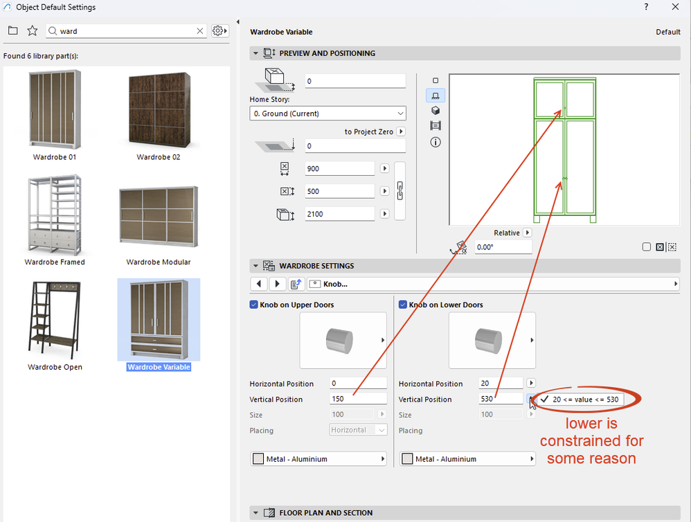

Superswabey
If using a unified object, what object can achieve this? I want to use modular wardrobe but it can only have sliding doors.
Unfortunately objects do not have an option to show/hide relative to the Floor Plan Cut Plane.
You can use layers.
Create a "furniture 2D" layer, "furniture 3D" layer.
Turn the "furniture 2D layer on in plans and the 3D layer off.
Turn them both on for elevations, sections and 3D views.
Turn them both on temporarily in plan while you are working on the file but make sure the plan view has the 3D layer turned off.
Lingwisyer
Guru
Given you have brought up the Modular Wardrobe object, you are not needing the increased door spacings and butt panels forming a cross? Can you just use the segment option in the standard cabinet object to add your top cupboards?
What about the variable wardrobe and adjust the bottom section height and the handle heights.
Superswabey
Hello, I tried this one. I can make the carcass as per the configuration inteded, although i cant seem to raise the door handle higher for the lower doors. Maybe im missing something.
Seems to be a bug in the object.
The lower handle height is constrained - I don't know why.
But, the taller the lower door is, the lower the handle has to be.
Looks like someone got their math calculations mixed up.
Without saving a copy of the object and then editing the script, I don't know any way to change it.
Except turn the handles off and add your own.
