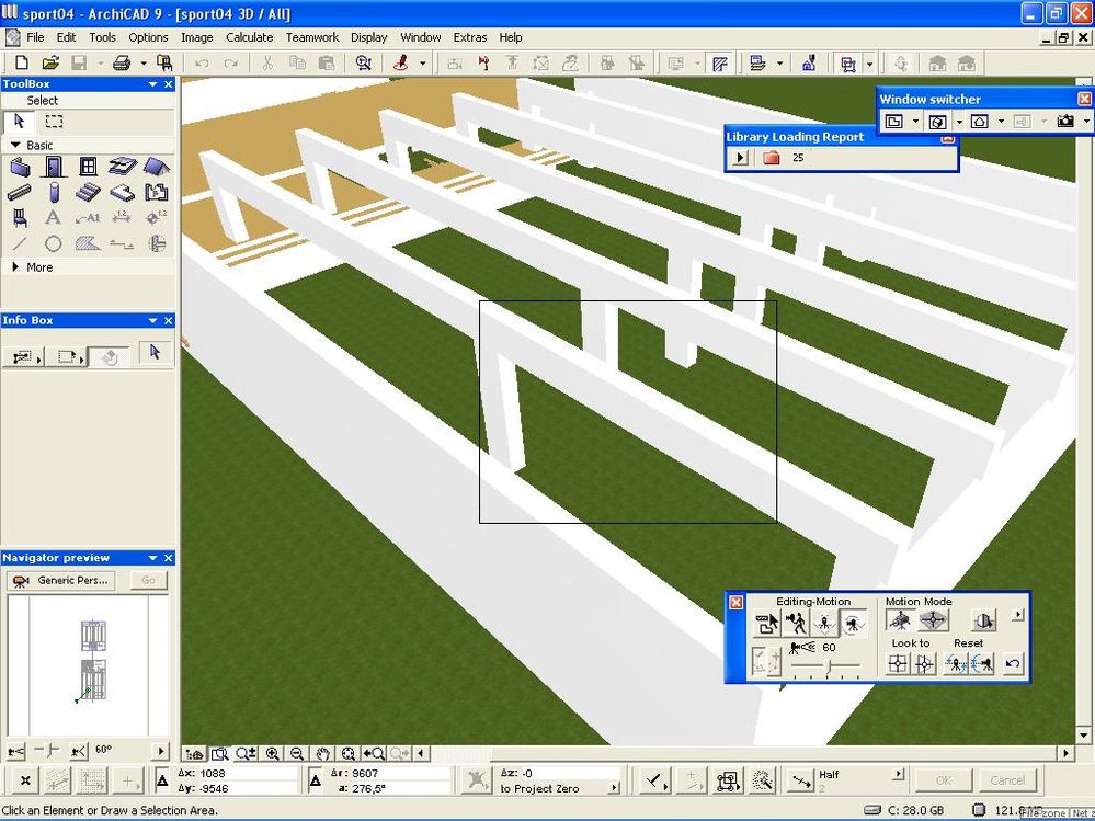

Can someone tell me how to make non-horizontal beam (beam that is not horizontal, that is for example under the roof instead of wood construction)? I know I could make it with gdl blocks or pick the wooden rafter from roof construction and change the material to concrete, but this is not a solution for profesional planners, its time and energy consuming, and beside that, it will not be presented in 2d floor plan with dashdot centerlines and dashed contour lines, i would have to draw them manually (more extra work).

I think you'll find that a beam can only be horizontal for now. It is a long-standing wish that sloping beams be allowed. You may be able to find another standard object that displays the way you want. You will find that the "workaround tool" (not documented) is used a lot.

If you don't want to use an object then how about trying the roof tool.
You will need to draw it in a different manner (i.e. draw the perimeter of the beam in plan) but you should be able to get what you want.
The tool names can be a little misleading.
The wall, slab and beam can all be used to model exactly the same element, just with different methods of input.
A roof is just a slab but on a slope.
A wall can also be cut so its top and bottom surfaces slope (a sloping beam).

I usually use the roof tool for sloping beams. However, if you want centerlines, you'll have to use the wall tool instead. Draw the wall, then cut it above and below using roof elements as cutters, either with "trim to roof" or with Solid Element Operations, in which case the roofs have to stay on as invisible operators.

The trick with roof tool works (I mentioned it in my question) just like cutting-trimming walls, but it takes much more steps to get result than I would like, but you helped me to better understand how archicad works.
