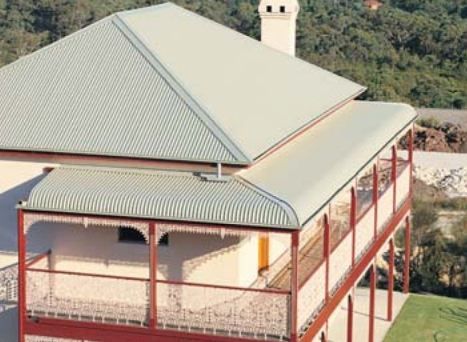

... bullnose verandah. Not sure if this is just an Aus term but it is essentially a verandah made with curved steel roofing sheets. It is easy enough to model this with a complex profile then put a vectorial hatch on it to represent the ribs of the sheeting but being a pedantic bugger I want something more detailed. I use the cadimage roof coverings which actually show the ribs of the sheets accurately. Is there any way to extrude some sort of corrugated profile of a single roof sheet (easy enough if it was straight with complex profile) but have the extrusion curved to the shape I want. I hope I have explained things properly.

Yes I should have done this first. See attached pic. Essentially what I want to do is instead of extruding a simple profile horizontally for the length of the verandah that would not include the sheet ribs I want to extrude a complex profile of an individual sheet (the complex profile being the corrugated shape) into the curved shape. Maybe this is possible with the shell tool? I have not used the shell tool yet.
