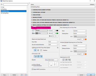

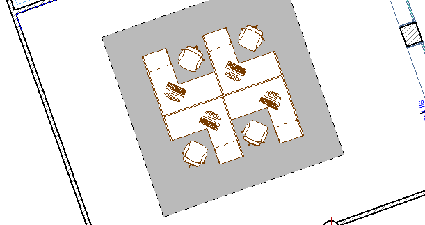

Hi. After placing objects there is gray surface under it which I can't remove. I'm using Archicad 25 student US version. Any suggestions?

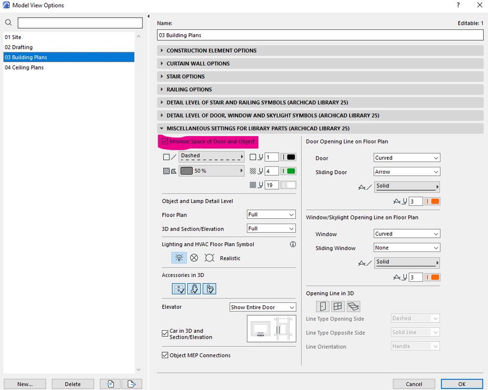

Looks like the Minimal Space display option is activated under Model View Option.

‎2022-02-12 03:26 PM
‎2022-02-12
03:26 PM
Thank you. It is working.
