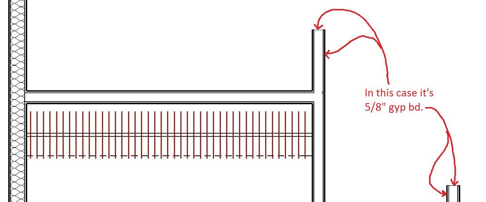

How to show finish mat. at wall ends?
Is there a way to have the gyp bd., stucco, or other wall finish material wrap
around the end of the wall?
19 Replies 19

The Wall End Tool:
http://helpcenter.graphisoft.com/guides/archicad-17-int-reference-guide/user-interface-reference/too...
For whatever reason, the page above doesn't show a plan view, but it achieves what you want.
Thanks Karl!
Never even noticed the wall end tool. Of course, I didn't need it until now as this is the first job I have done using the composite / skin feature of archicad.
Very excited about the time it's going to save. Thank you again for the help!

You're welcome. But, it should blend perfectly with all skins for an even wrap. Hard to guess from just a screenshot what might be keeping it from happening for you.
You could select just the wall and the end (2 items only selected) and save as a MOD (be sure to not check the box to replace the elements with a hotlink to the mod), zip that, and post it here for one of us to look at the parameters.

Took another quick look into the wall end dialog and gypsum board 328126... is not available there - maybe that is the problem - the walls are comprised of materials from the "building materials" and the wall end tool materials are from the fill types which don't include the same listings for fills.
This seems strange to me, because one would expect the wall end tool to have the same selections as the wall?

Easy solution. You selected the 'Cased End' wall end object. Simply switching to the 'Wrapped End' cleaned things up.
