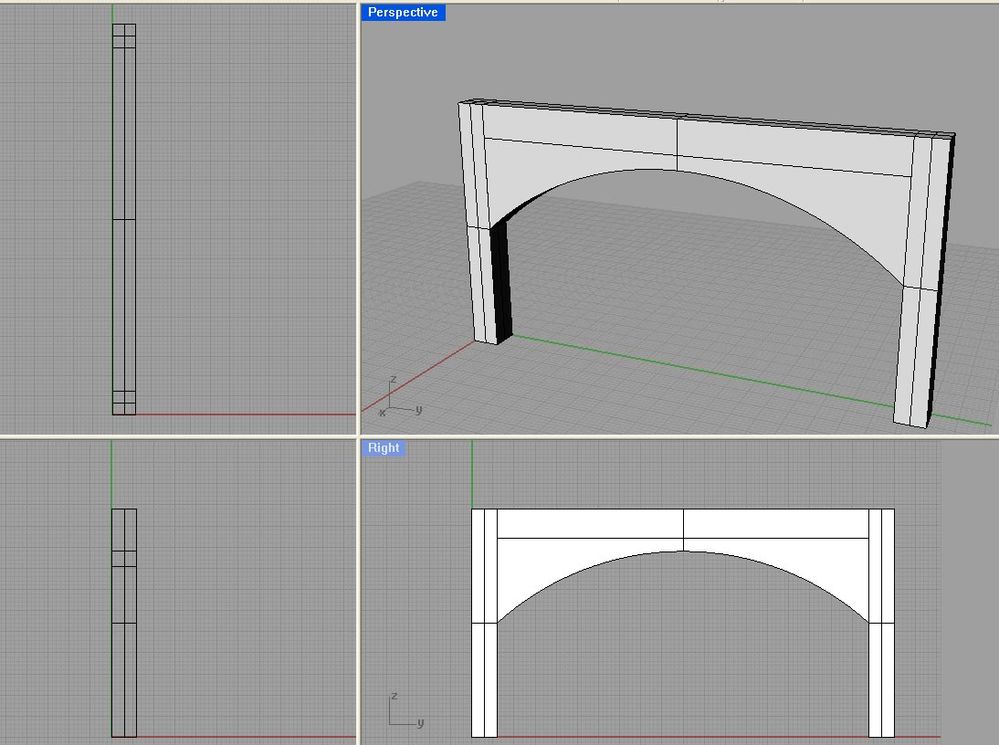

How would you model this?
Help please

Hello,
draw it using the slab tool which means draw it on the floor.
Then save it as object. Open the new object and add in the 3D
script ROTX 90. You need to delete the 2D script and to write
instead PROJECT2 3,270,2
All the best
Jean-Luc
Could it be possible to just rotate the slab around x axis in selected point?
I don't think so. Too complicated to program it given that you
deal with the 2D interface as well. You need to pass by the GDL
object script...
Cheers
Jluc
Yeah it seems so
Jean sorry for asking, but could you write step by step how to do it
Im a kinda beeginer here so I didnt understand you a word when you explained it, post earlier
I would just do a wall with a "semi arch" top opening. While in the door tool look for openings.

I didi the folowing:
Selected the object,open it in 3d view, set paraleel projections , top view, then , file- libraries&objects - save selection as .gsm...what next to do...
saved as "myarch.gsm"
then open object
choose your object
Then you access to the script of your object
go to 3D script add ROTX 90
go to 2D script delete the script and
write PROJECT2 3,270,2 (projection on
plan xy )
