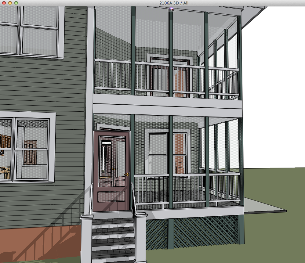

Rather than try to describe how I make screen, I'll post screens shots. This is in 17, but 16 etc is similar. I use a dedicated composite. Make sure you have transparency selected in 3D. I place post with a beam at the top, and a rail at the bottom, then run the screen like any other wall.
Rick Thompson
Mac Sonoma AC 26
http://www.thompsonplans.com
Mac M2 studio w/ display
Rick Thompson
Sorry, I should have used the internal engine for the rendering... but you do get a shade difference with OpenGL too.
