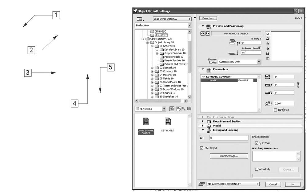

Then I drew a circle with a 1/8” dia, saved it as an object, reopened the object and added a title parameter that says “Keynote” with a text parameter that says “Note” and resaved it as “Keynote Object” in my library part dir.
Opened object settings, found the new “Keynote Object” and saved multiple copies of them as a favorite on its own layer in the newly created layers listed above. Then opened each saved favorite “Keynote Object” in object settings, checked “Label Object”, clicked “Label Settings…” and assigned a newly created label from the label Favorites (with the same layer as the “Keynote Object”), closed Label Settings, assigned #1 for the object ID (at this time you can place your keynote comment under the objects parameters or place your “Keynote Object”, reopen it and add your comment) and closed Object settings.
I can now place the “Keynote Object” with the attached Label. The object and label are placed with one click, it would have been nice with three clicks so I could place the label where I want but I guess I can’t get it all. I just have to stretch the label around the way I want after placing the object, but it doesn’t seem too bad.
