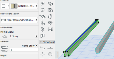

I would like to change only the standard story in the current state.
1. BEAM
AC27 on window 11
1 Solution

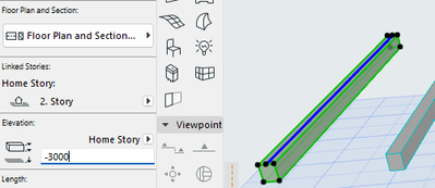

Hi
you can right-click the element and then use the function Relink Home Story
Further information: https://help.graphisoft.com/AC/26/INT/_AC26_Help/040_ElementsVB/040_ElementsVB-4.htm#XREF_90811_Reli...

LeeJaeYoung
thank you so much ^^
