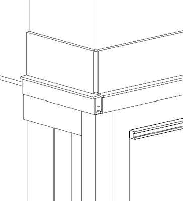

I would like to know tips when making a profiled wall.

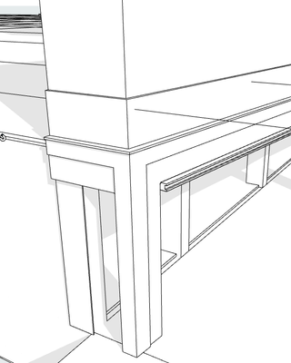

When exporting to ifc, this phenomenon occurs in the case of profiled walls.
archicad
revit
AC27 on window 11
1 Reply 1
This usually happens when geometries are exported as extruded geometries.
Make sure you export IFC as BREPS (boundary representation) which will guarantee exact geometry export.
