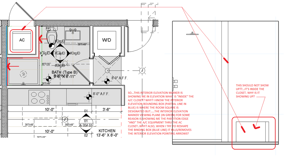

see attached.

I'm noticing that every single interior elevation boundary box that is drawn to a room that is not a perfect rectangle shows this glitch.
Now...again, when I try to zig-zag the binding box the interior elevation arrow disappear and are not longer functional.
If I leave the binding box as a "perfect rectangle" (now..what room is a perfect rectangle??...none) but if I leave the binding boundary box as perfect rectangle....the interior elevation that is generated doesn't read properly....what gives here folks??
GS?..any advice? I despise using "white-out cover fills" to bandage these strange viewing glitches.

Check your marker settings under "Model Display". I'm guessing that "Exclude view blocking walls" is checked.

"exclude view blocking walls" is checked....what should it be?
should it be unchecked or checked?

It would have been quicker to uncheck and see the results than respond to this post!
If it's checked, it means you have "x-ray eyes" and will see through any wall that stands in your way. Here, that's not what you want.

geez....why even have this feature in an interior elevation tag?
I mean..really?
What would be the benefit of being able to "see/show" what is on the other side of a wall???
it also appears that the default has the 'check' ON.....which you'd think would be defaulted to having the 'check' OFF...

There are times you'll find it useful, for example when you want to show a wall beyond a shower enclosure that you've made with thin walls.
But you can create your own defaults, you know. However, I agree that this particular marker has a trap for the unwary.

you are a wise man Richard.
thanks.....for teaching me something new.
I remembered that these interior elevations had some sort of trick...but it's one of those "check boxes" that you 'set and forget'.....that and my advanced years don't help.
but in all seriousness....thank you for your insight.
