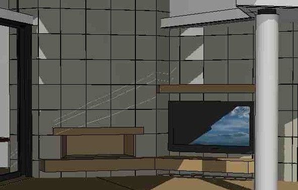

I'm Modeling 2 x 2 veneer tiles and am experiencing erratic surface rendering behavior in open GL. Have always had this problem when moving around in Open GL and have had to adjust the view in order to capture a place where most of the surfaces look correct, esp. when I have a TV with a jpg image on the screen.
Does anyone know what I am talking about here, or is it my graphics card or something?
Is there a setting somewhere that will mitigate this problem?
Best to all!

Do you mean that the some surfaces are flickering when you move in OpenGL?
If so, that happens whenever two objects occupy the same space. Moving/resizing the objects so that they do not overlap, or using a SEOp to subtract one from the other to eliminate the overlap resolves this.
If something else, yeah, a screenshot will help. Just compress the screenshot to under 256 kb ... and there is a size (width/height) limit that isn't published, but decrease the size if file size alone isn't enough to let you attach the image.

here is a jpg of the problem.
The TV is a good example, it has a picture that is jagged and incomplete.
If I navigate around in the 3d window it will flicker from jagged edges to no picture at all to a complete picture and if I stop navigating right when the picture looks good it will stay there until I start to navigate around again.
The tile on the wall also shows this, some tiles are deliniated correctly and some have streaks and highlights and dark spots that are not sun shades and shadows.

Anyway, you can see 6 tiles that have corners that are not rendered and some streaks across the tile faces just above the fireplace.
The TV has the picture (a selected jpg in archicad) only on about half the
screen and jagged edges.
I have never been able to figure out what the heck is causing this, but it occurs on every job I do and on every computer I use (3 over the last 8 years)

Assuming you're on 15 (your signature) - the Plasma TV 15 displays the picture fine for me; rock solid.
If you're using that same library part... and the image on screen is from setting the parameter for 'use custom picture', then try copying just that part into a fresh/empty file and see how it behaves. Pull your tiles away from the wall ... or since you said in the other thread that they are on their own story, select only the tiles (not your grout plane) and see what happens.
You might have some weird stuff far away in space? If you marquee just the area shown in your screenshot and view that in 3D, does the problem continue?
Also: Your graphics drivers are up to date from the manufacturer's web site?
