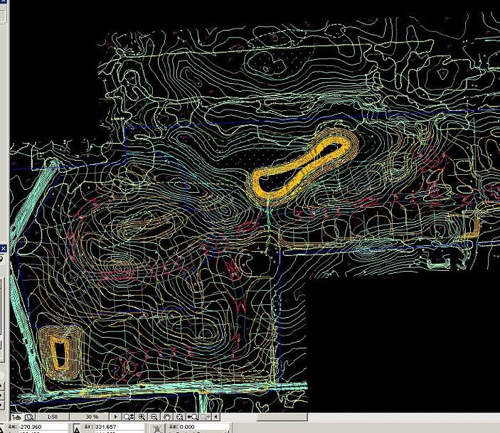

Hello all,
I've got yet another question for the elders (just to let you guys know, I think I would've been fired by now if it wasn't for all the help ) anyway, so heres my new question, we get our drawings from the land surveyors in 2D DWG format, what, in your opinions would be the best way to go about turning these contour lines into a 3D mesh ? I've included a screenshot of a typical contour drawing, as they are when I get them.

The one below was created using the mesh tool.
It's a bit of a long winded process, and you can't RTFM because it's simply not in there, but basically you need to:
Connect all existing imported 2D lines so that each contour has no breaks;
Magic wand splines over each one;
Create a mesh the same shape as the site boundary;
Select it and magic wand the splines to add contours to the mesh;
Set the heights of the mesh boundary nodes & each contour.
That's it in a (freakishly small) nutshell, and it does deserve a much more thorough explanation, but unfortanately I am sitting on a sidewalk in the town of Lewes, East Sussex helping myself to someone's unsecured WIFI access whilst instant messaging my wife and, quite frankly, my _ass_ is getting cold.
Never mind though, trial and error will be your best friend in keeping you from being fired - trust me.
Cheers,
Link.

I've just actually found out through talking with my engineering company that when they draw the contour lines they use a programme called Land Desktop from autodesk, and then when they send the drawings to me in DWG format they actually explode them, to create the poly lines. I was wondering if anyone had ever heard of a plugin (I doubt it but its worth a shot...) that would allow archicad to import directly from the Land Desktop "civil contour lines" to a mesh.
any ideas? I'll dig around on the intraweb too...
cheers,
Dan
cheers,
Dan
If they can output XYZ points, ArchiTerra might do the trick.
