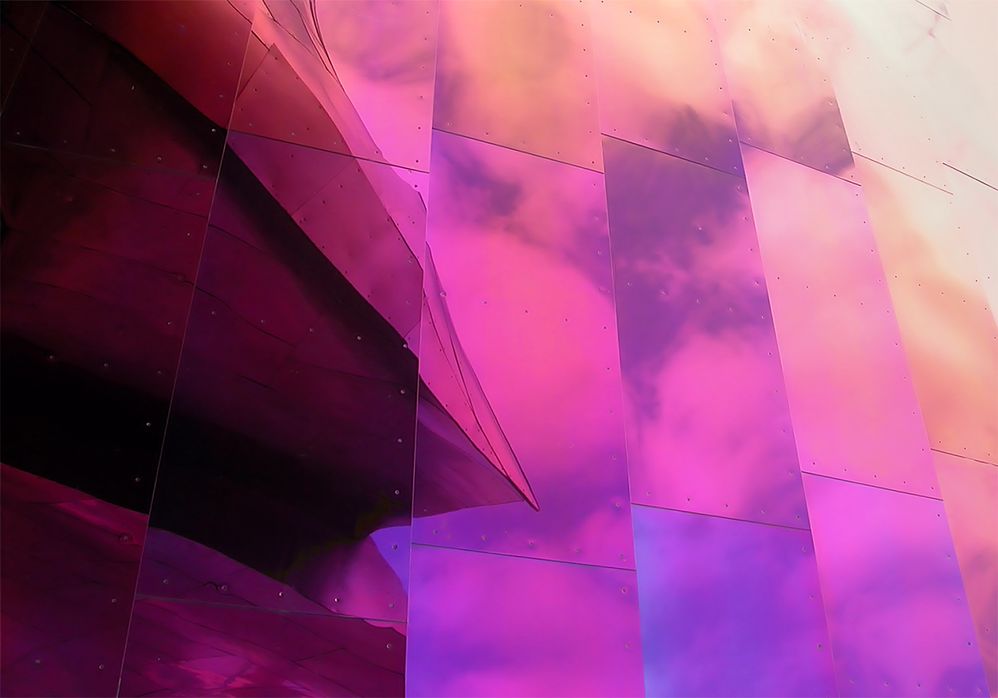

I've played with parametric, diamond/rectangular tiles that interleave and mesh components that describe double curves. The attached image [EMP, Seattle] shows how one might address the roll under with meshes for more fluid form, since ArchiCAD meshes cannot "roll under" from the vertical.
When you think of these forms as tiled structures made from manufactured components and not amorphic snot blobs, it helps, because ArchiCAD works that way. Besides, ever look at the fit and finish on the panel edges Disney Center? Shame. ArchiCAD can easily make a mess like that.
