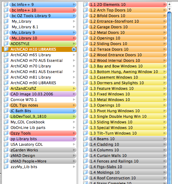

With each version up grade I have always duplicated my working library, and renamed it. e.g. I created My_Library as far back as 6.5 and since just renamed each duplicate the current version number.
So now it is My_Library 10.
Apart from adusting macros and various add ons through the upgrades all my parts work. There is never a problem when tweaking a library part as it is saved in the current version that is being used. Going back to previous projects that have not been saved as .pla files is not a problem.
For the last 10 years I have never loaded any GS default library as such.
I have always treated them as you would a "public library" ie. see what you need copy, together with reqiured macros and paste to your working library.
Some offices I've worked for, have had any and every library loaded, hugh file sizes.
As far as Kyle's comment about loading both 9 & 10 libraries, this is something I'd never do. Simply because, should you amend/tweak/update a 9 library part whilst working in 10 you render that part unusable in 9.
One of the most frequent comments made to me about AC is the difficulty in getting about the default library.
For a start the way the folder structure is set takes someone of Houdini's magic to find things quickly. ':?:'
Have a peek at attached view of my AC Master Library folder structure.
And finally never work from your library as .pla.
