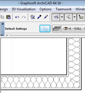

Out of the box AC16 does this if you use the symbol fills: 07 | Insulation-01. Turn on the fill orientation in the composites settings to "fit to skin". Very nice output. Applies back to AC14, perhaps earlier, not sure.
