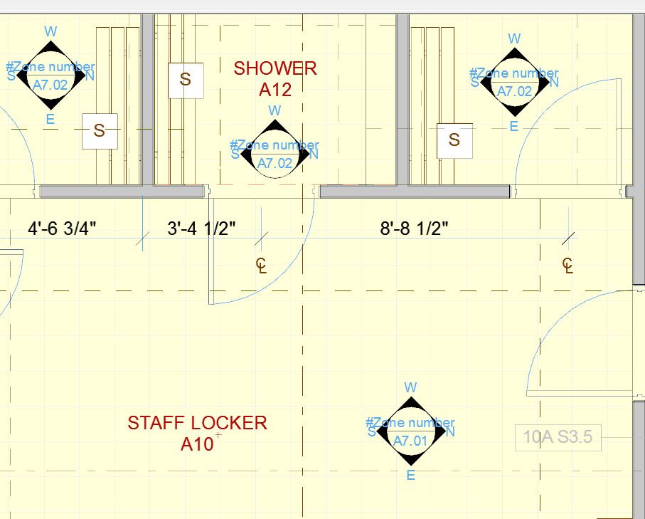

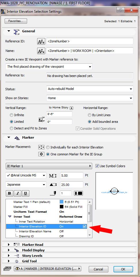

But then when I close out of archicad and open it up it is back to as it appears in the attached screenshots.
To fix it I have to move the zone title or delete and reinsert the <ZoneNumber> option under ID as seen in the second screenshot!
Please Help! I can't understand why it won't correctly reference.

that's an interesting idea., but no. no hidden zones. and i'll just mention again: it works if i open the interior elevation selection settings and uncheck and recheck the box i have pointed to in the attachment it updates the reference as it is SUPPOSED TO! until i close out of the program and open it back up again to find it not referencing.
