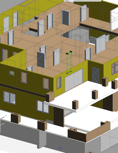

I am not sure what I am missing. My interior walls are not showing up. They are all 'New Construction' similar to the exterior wall. Please help.

It looks to me like your interior wall layer is set to wire frame in the layer settings.
But looking at it again then your doors would be wire frame as well.
Have you applied a transparent surface to the wall (or building materials)?
Or this could be caused by a Graphic Override.

Thanks Barry.
Yes, it is the wall setting/model/override surfaces. The model now has the interior walls showing.
