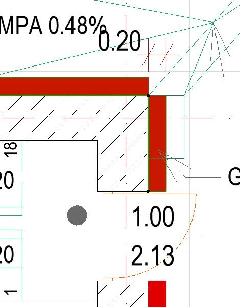

I again have issue with walls intersecting. In image no 1 I have two walls of same height and thickness that meet. I cannot get them to intersect, and when I finally do, the two adjoining thick walls go one over the other, like in image no 2.
What is wrong?Thank you.

I think you have 2 sets of walls - thick block walls and thin red walls? If so, change the layer of the red walls to a layer that has a higher or lower intersection priority.
The usual way of modeling this is to create a composite wall type that has a thick block skin and a thin red skin. The composite wall has the advantage of working well with doors and windows, the two walls are going to give problems and coordination headaches all the way through the project.

Thank you for the answer. The issue is solved.
