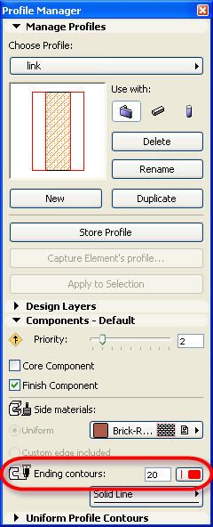

See attached screenshot: for the priorities that you set up in the profile to be considered, you must check the box for 'Enable Skin Priorities'.
(Generally, for composites and profiles, I have all boxes checked so that the composite or profile definition defines all attributes, thus making the definition a 'style' or 'type' that can be edited in one place and changed everywhere.)

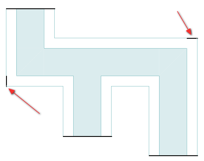

In the process of reproducing your screenshot, I discovered an unpleasant situation in 11 (have not tested in 12) regarding the 'Ending Contour' pen for the complex wall profile.
See the attached screenshot. The full ends show the heavy black line, but it also shows up as a short segment on one side of one skin of a wrapped corner. Pretty bizarre. Anybody have an idea on that one?
Cheers,
Karl

This gets weirder: in 12, the short end segments are still there, but on opposite sides of the corner. But, in 12, I cannot seem to control the weight of the contour cut by the floor plan cut plane.
No matter what pen I assign, the outside contour lines are always the same weight. The teal/blue pen is hairline (0 mm) and the red is 1.00 mm, but they appear the same in the attached screenshot. The pen color is clearly being taken from the Profile Editor, but I have no idea where the weight is coming from...?
Karl
Karl, are you assigning the Ending Contours in the Profile? Of course all the Structure's Settings must be applied in the Wall Settings.
