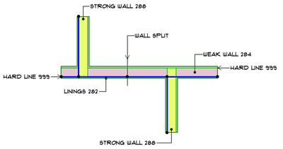

@Lee Hankins Depending on how you work there is a trick. Unfortunately it isn't very BIM, but it can be managed. Create your two wall types, but for the weaker one you add a line that can't be crossed using a high strength material that is as thin as possible e.g. 0.1mm so it isn't visible and won't be identified in 1mm dimensioning.
Parts of the weak wall can be flipped as necessary.
Depending on the strength of the hard line it may also project into other walls, so that's one to watch and manage by reducing the strength.
You could have two different linings with a strong and weak material but that risks creating awkward joints in sections & plans between materials and could be awkward for material schedules / take-offs.
If you use Complex Profiles you can also manage this material by turning its width on and off. But that's a far more complex discussion.

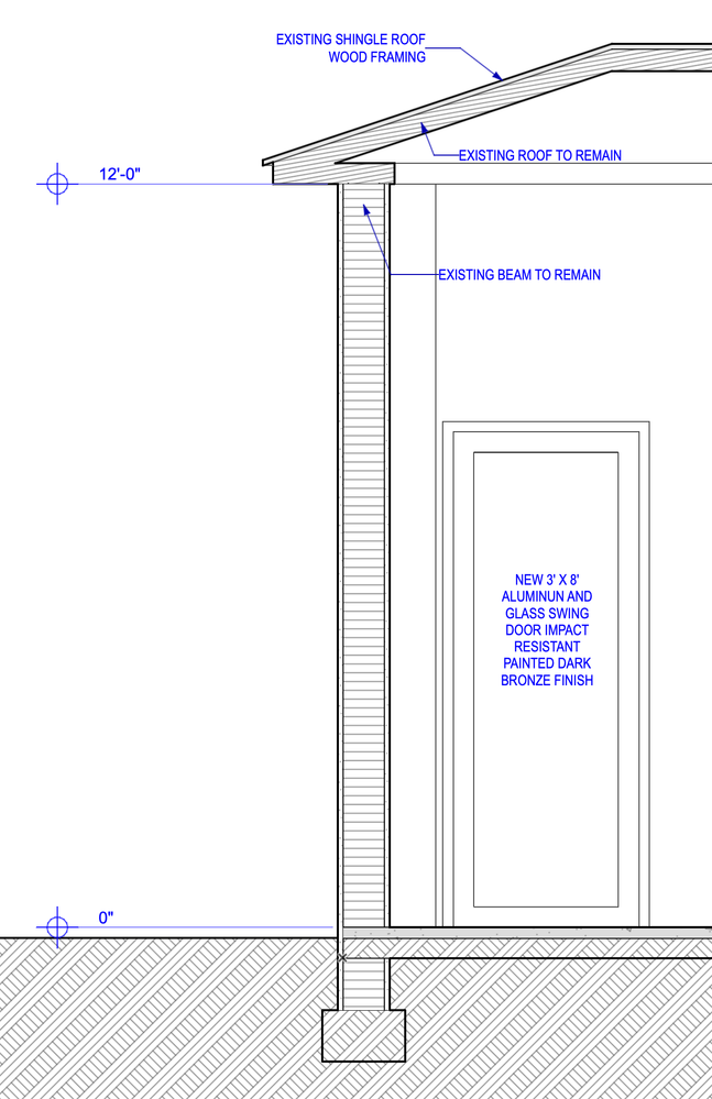

I(n Section View, I can't intersect a composite wall material (strong) with an Mesh Earth Material (weak). Why is AC26 not working the way it is supposed to?
In the past the quick fix for this is just to use Display Order > Send to Back, to put the Mesh behind the rest of the drawing.
Apple iMac macOS Ventura / AC27UKI (most recent builds)
Walls and mesh will not intersect automatically.
You have to do a Solid Element Operation.
Display order may help if the elements have solid fills, but does not actually cut any elements from another.
