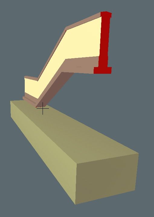

It is a toss-up as to whether this is easier or not, but it does deliver a potentially more complex section.
Use a complex profile in a beam - beams tilt.
The problem is that when tilting a beam, the section also tilts - the wall gets too large to match adjacent horizontal walls.
The answer is to stretch the wall upward. You design the wall to its minimum height and stretch it up to match taller,tilted parts.
