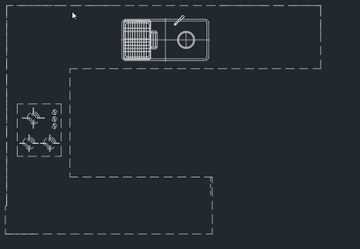

Is it possible to express the sink like this?
LeeJaeYoung
This question was asked because there are hidden wires in the connection part.
Where is this explained?
AC27 on window 11

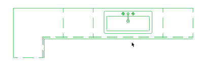

Ricardo Lopez
Maybe you could play with detail level set to low and 2D representation settings, where you can change linetype to dashed for the counter.
Also 2D symbols and 2D lines are always available as an emergency resource. 😁
