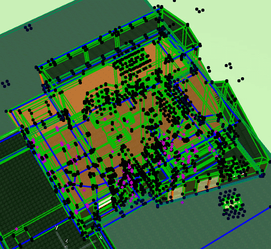

Is it possible to select something to hide it in 3Dwindow?
Now you have to select - marquee what you want to see in the 3D window.
I want to do the opposite - I want to select the objects I want to hide.
Is it possible to do that? Some hidden command to do that?

To approximate this you can set the Find & Select criteria to what you want to hide. Select everything in the 3D view. Deselect the elements to be hidden by the Find & Select criteria. Then use "Show Selection/Marquee in 3D" to hide the unselected parts.
For just a few parts you can just select all and then shift click to deselect the bits you want to hide.
This ArchiCAD method actually ends up being easier in many cases, as well more powerful, than the Revit approach given the difficulty of making multiple, detailed selections in Revit.

I now know it is not possible to select what I want to hide in the 3D view like in Revit and Sketchup. Now it is just a mess having Select All elements trying to deselect some element to hide.
