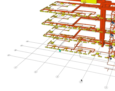

What looks like a grid below?
I couldn't draw lines in the Archicad in 3D.
I solved it with morph.
The text was also solved with 3D text.

Grid lines? Those are Grid elements and they are present in Archicad since a long time. You can find them (individually or in a Grid System) in the Grid Tool.

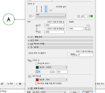

Jihoon
show as a line

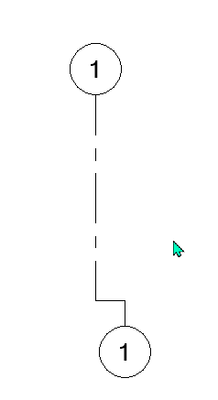

The current Grid is a bit inconvenient in my practice.
Normally, you should be able to drag the grid by element, but Archicad doesn't seem to support dragging by element yet. It's only possible in 3D.
In Revit, 90 degree bends, which I mainly use, are possible. It seems that Archicad needs to be edited with GDL.
Usually, it is expressed as follows, so I do not use Grid in Revit and Archicad.
