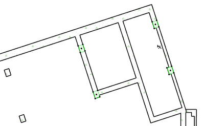

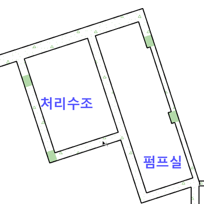

Is there a way to mark the columns in the wall?
LeeJaeYoung
AC27 on window 11

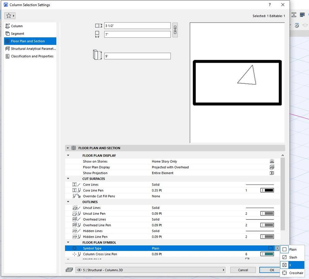

There are a variety of floor plan column symbols in the Column Settings, these are also controlled by MVO.
Alternatively you could apply a GO to highlight the cut fill & boundary of the column.

sknsnw9
is this what you're looking for?

It also doesn't show borders
AC27 on window 11
You should change the building material of the columns. Also pay attention to the building material intersection priorities.
