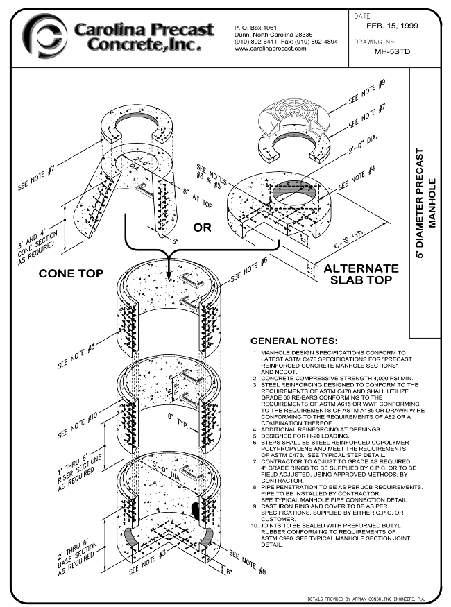

I really like detail drawings like the one attached, in which text and dimensioning appears to be drawn in different planes, then appears properly "distorted" in an isometric view.
Can this be done in AC9? I think the answer is no, but perhaps there have been some recent developments of which I am unaware (only recently upgraded to 9 from 7). Using 3d text would not count as a workable suggestion!

Thanks, guys. The drawing part I have under control, and use a lot for developing exploded details, as suggested.
But the dimensions appearing in the "picture plane" look funny (i.e. bad) against the isometric object, and frankly, being able to choose which plane to insert text adds another layer of clarity and significance to each note.

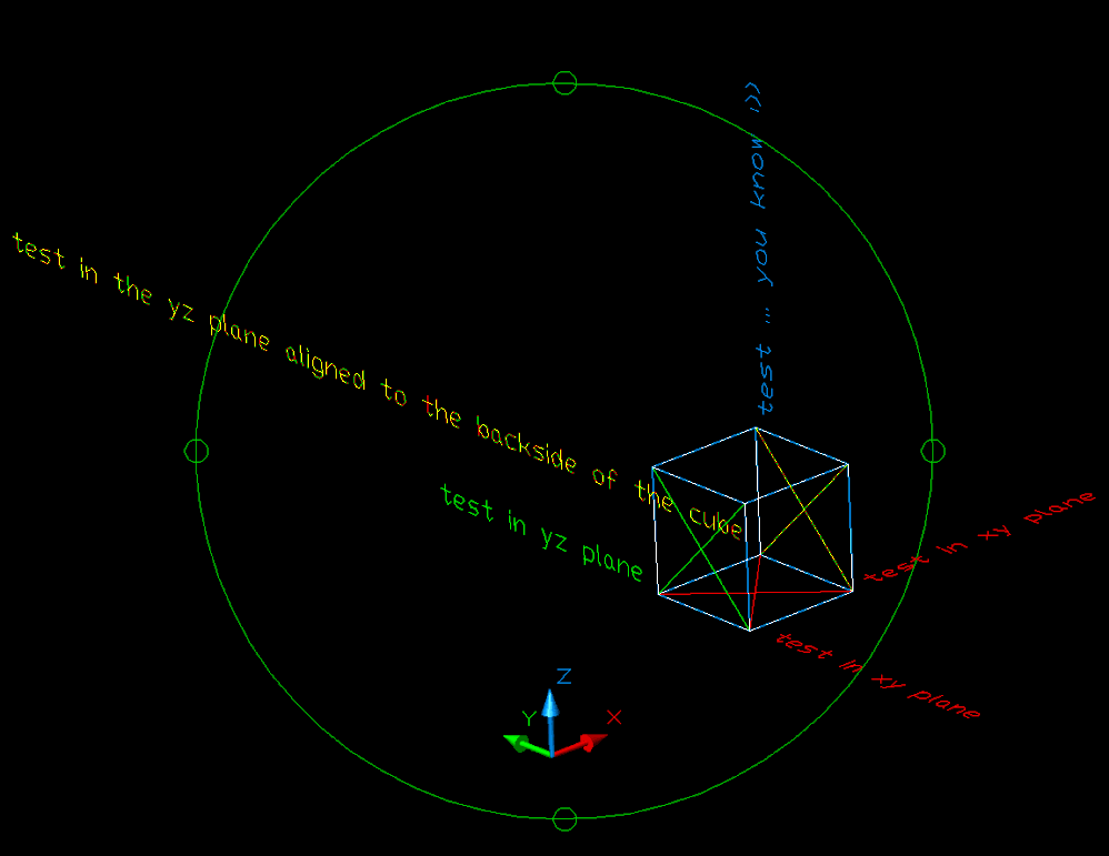

Yes! Nice idea, Robert!
We should be able to type text in 3D view and align it to different planes!
I have never needed to present an exploded 3D view of my model but it would really be a difficult task to do it in AC properly. All the suggested workarounds are not good because when you rotate the view all the texts become obsolete.
Just for nagging: AutoCAD has this feature since its creation many years ago.
