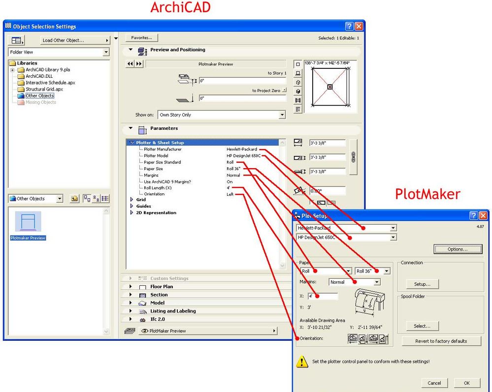

Yes - I have created a part called PlotMaker Preview with Miguel Ladouceur that lets you preview your sheet in PlotMaker. It works wonderfully, and was demonstrated at ArchiCAD University. We have continued to test it since and are satisfied that it is completely bug free.
Miguel will be uploading it to objectsonline.com in the near future, but if you would like to purchase it early, just PM me.
It really is a powerful tool that previews exactly how much room you have on your sheet. You enter all the exact same settings into it, as you do to set up your sheet in PlotMaker. It allows for titles, titleblocks, ArchiCAD 9's grid numbering, and is completely scale sensitive. It takes all the guess work out of how much room you need in your model and will even let you position your plans, sections, elevations and details on your PlotMaker layouts before the model is built.

Well here's a preview of the page that explains how to setup the library part to match the plotter...
There is a lot more to it and it's all very intuitive.

So, you border becomes a library part??? How cool is that!!
Great job, Link!
