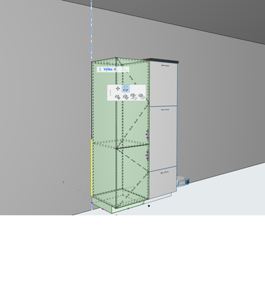

Hey all,
Having issues with using the 'stretch height' command in 3D. It seems to jam up the program, the only way to fix the issue is click off along the top bar of the window and then back into the working space.
Seems to be happing across the board with this command in 3d - not just isolated to cabinets.
the X marks where i need to click to get it back. This is the same across a team of 8.

AC 29 -> kitchen cabinet:
FREEZE.

I had the same issue under AC28.
Hate to admit it, but what fixed this (or significantly improved it) in the end was reinstalling Windows 11.
Updating all drivers, updating Windows 11 to the latest release version and uninstalling and reinstalling latest version of ArchiCAD 28 was not enough.
It seems that a bunch of spurious background web browser tasks were being generated every time ArchiCAD loaded - possibly related to the ArchiCAD licensing system or the ArchiCAD help system.
These tasks seemed to interrupt/ freeze or time-out ArchiCAD's graphical feedback system during sufficiently complex editing operations.
Manually closing these tasks via Task Manager helped, but it was still necessary at times to click outside the ArchiCAD window then back on the ArchiCAD window to break the deadlock.
It is possible that an earlier ArchiCAD 28 update broke something in the registry, or perhaps failed to register itself properly with Windows Firewall during installation.
A fresh install of fully updated Windows 11 and fully updated ArchiCAD 28 worked much better.
No such problems encountered (yet) under AC29, thankfully - I really don't fancy having to reinstall my OS every time ArchiCAD starts slowing down or playing up!
